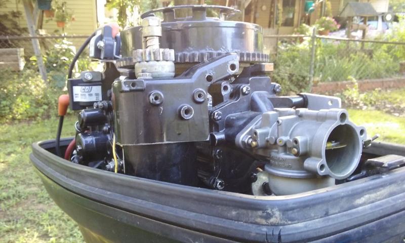

Recently bought a boat with this motor attached. I think I might have the wrong starter. The shift cable bracket sits below the starter. With the starter installed, the shift cable can't pass under the starter to connect the cable to the shift linkage. The shift bracket cable clamp was installed on the bottom of the shift bracket which makes the clamp screws impossible to get at when installed.
The starter is an ARCO 5382, about 9 1/4 inches in length. Can anyone tell me the length of the starter on their 35 hp?

I don't have a good pic of the starter mounted, but I'll attach the best I have. The other pics show the starter sitting on the shift cable. I thought it was hitting the shift bracket, but it's the cable. The cable clamp was attached to the bottom of the bracket when I got the boat. I guess that might have gained 3/4 inch or so of clearance but not enough. I noticed one of the starter bolts broke off in the block which allowed the starter to pivot and gain a little more room.

Got the starter in yesterday, swapped the bracket, and installed this morning. I'm not sure what the taller starter fits, but it definitely was not right for my 35 hp. Here's a pic of the starters, sorry for the cluttered background.
That one fits the 85 90 120 125 150
