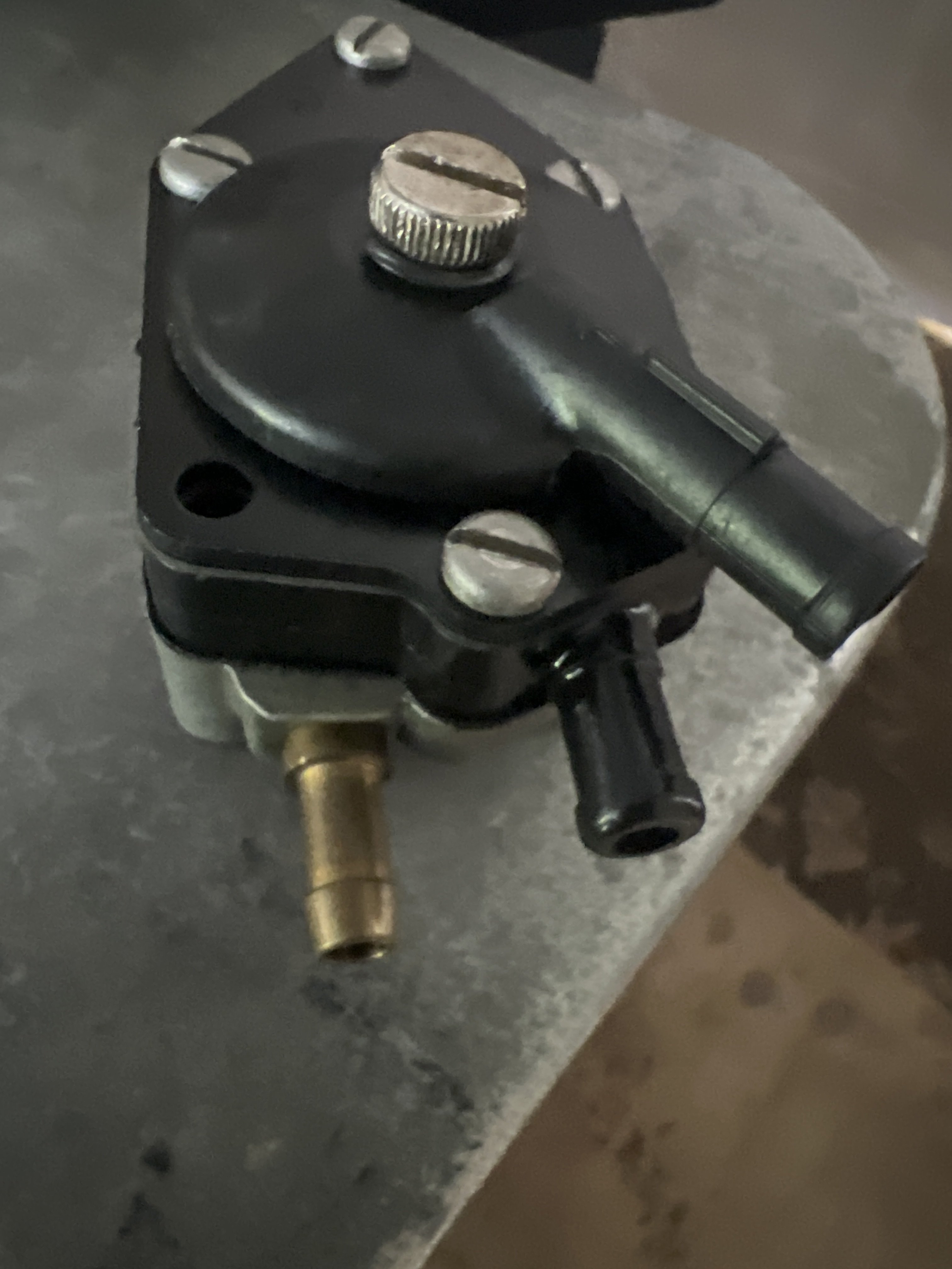

There doesnt appear to be any no coming out of the hose from the pump to metering circuutsThe fuel from the primer valve bypasses the carburetor metering circuits.-----Need to inspect / clean carburetor innards.
Theres 2 lines coming out of the fuel pump .theres no fuel coming out of the one going to the metering cicuits. Shouldnt fuel be coming out as you turning the motor over to start?There doesnt appear to be any no coming out of the hose from the pump to metering circuuts
But why is there no fuel coming out of the other line of the pump?If it runs when pushing in the key , the fuel pump is working fine.-----You have a blockage in the carburetor !!
