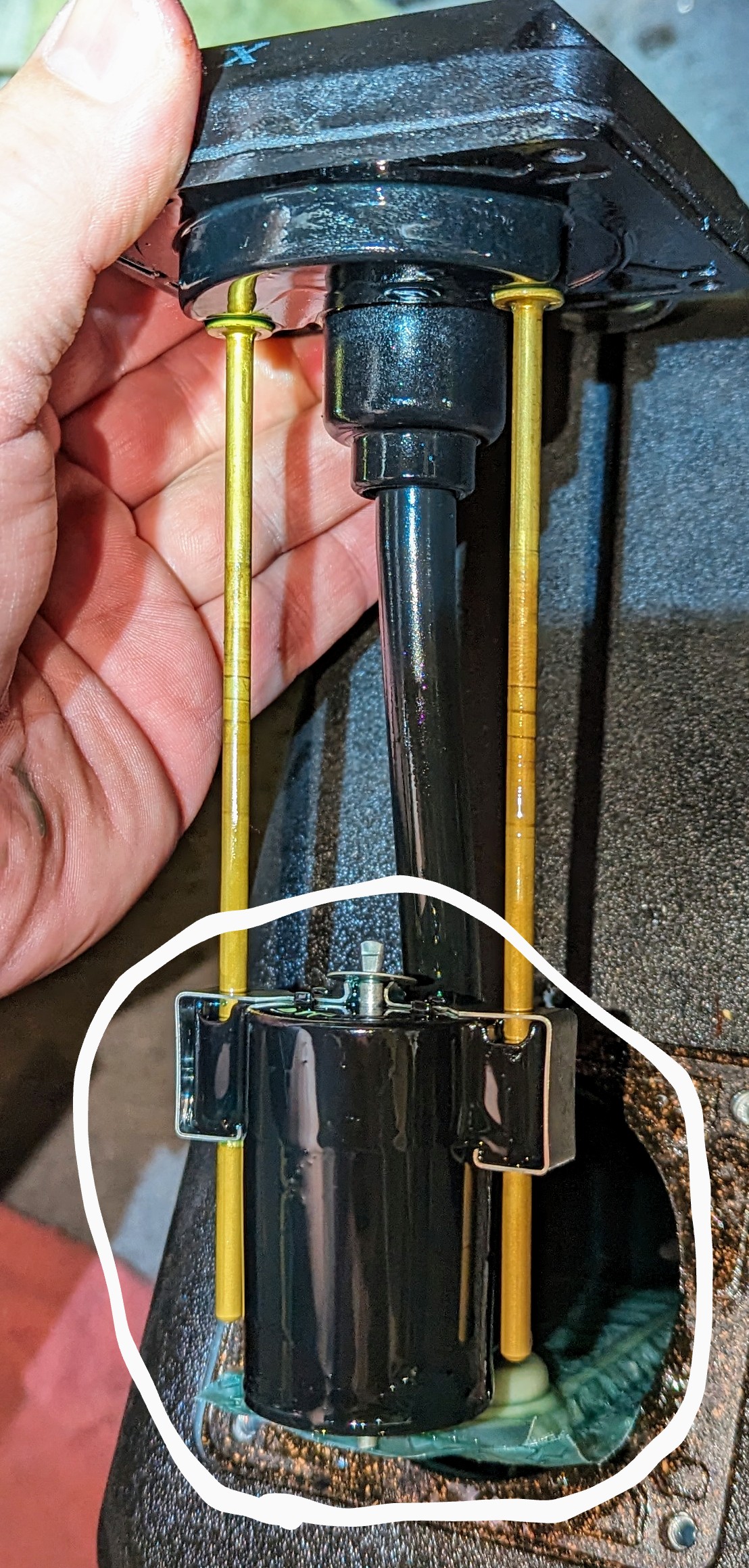

Remove the 4 screws that hold the float in the oil tank. Turn the key to the "on" position. The alarm should sound when you put the float at the bottom of the rod and should go off once you raise the float. If it doesn't operate correctly, replace the float.
Thanks Oldsaltydog,
Embarrassed to ask, but is this the float (circled in image)?
Is it supposed to move up and down along the two rods? If so, it doesn't move. Granted I didn't try forcing it too hard in fear of breaking something.
