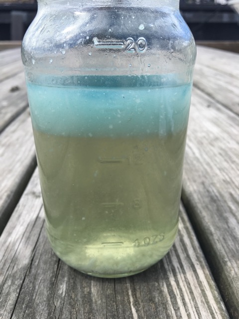

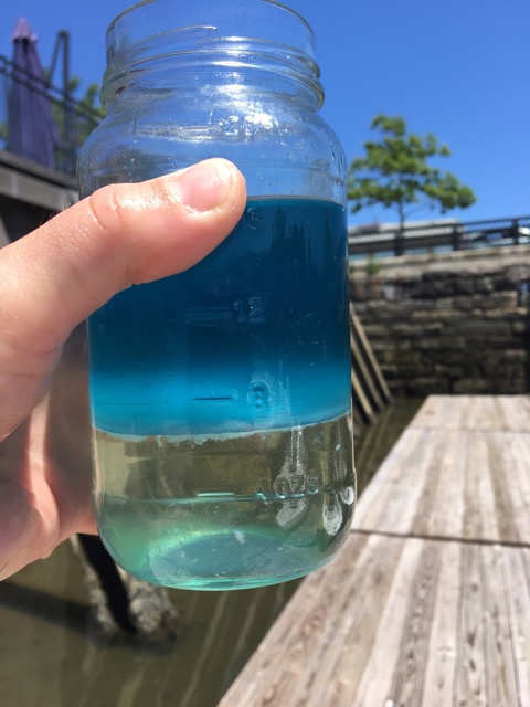

Hey all,
New to the forum. I have a 1976 Aquasport 170 with a 1990 Evinrude 88 SPL Outboard. I recently had awful phase separation issues in my below deck 27 gallon aluminum fuel tank. I believe it was a bad fill up from a local fuel dock. My tank, lines, filters, etc... are all brand new. I used my existing fuel line and primer bulb to manually drain the bottom of my tank. I endded up draining about 10 gallons until there was no more evidense of water or phase separation. The 3 pictures attached are when it was first discovered, after draining a few gallons, and after draining 10 gallons. My question is....does anyone know how to drain the carb bowls on this motor? Do i need to remove the carbs completely? The lowest screws I can find on the carbs are the plugs for the high speed jets. I am changing my fuel pump for good measure as well. Thanks!!

Those plugs will drain the carburetors.---------You just need to remove one of them on the upper carburetor and one on the bottom carburetor.

Wow, that's a nasty water infestation.
RacerOne is right, part #9 in the diagram is the screw to remove:

That is realy bad fuel contamination.
I think I would drain the tank completely and put that down to a bad experience.
Dont take any chances with bad fuel, its good you have caught the problem now and not at sea a long way out.

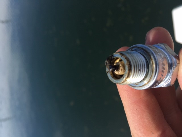

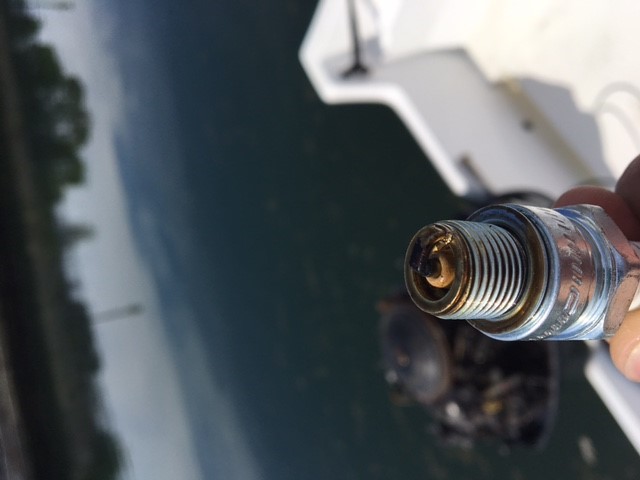

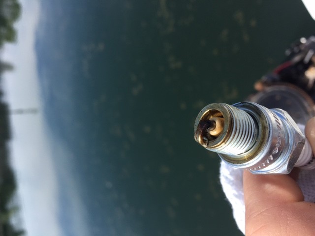

Thank you for all of the input!! Update: I've had the motor running at idle on several occasions now after the new fuel, fuel pump, and spark plugs. Still haven't had a chance for a WOT test run. I've attached pictures of all 4 plugs after a total of about 30 minutes of idle and low rpm run time. Last one looks a little lean to me but I'm no expert. I seem to have a constant fuel slick in the water behind the motor but I cant find any leaks. Appears to all be coming from the exhaust. She seems to run a little rougher than I remember but I could just be imagining it with all the testing ive been doing. Hopefully will have a test run soon.
Time to do a compression test.-----Post your numbers.-----These motors have a nasty habit of breaking piston rings.
Will do. I did one last year but I forget the numbers. I will post the numbers after completed. What about the spark plugs makes you think there could be a piston issue? Thanks.
