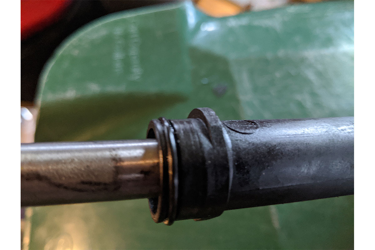

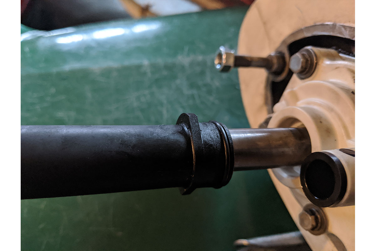

Right on....got it thanks! I got it all together, hopefully correctly. I replaced the o-rings on the black tube that connects to the water pump and in sliding it back in I noticed the little flanges on the ends of the black tube near the o-rings are slightly different. Of course I failed to mark which end of the black tube is supposed to go into the pump and vice-versa. I included pics of each end of the be. Any idea which way it goes?
