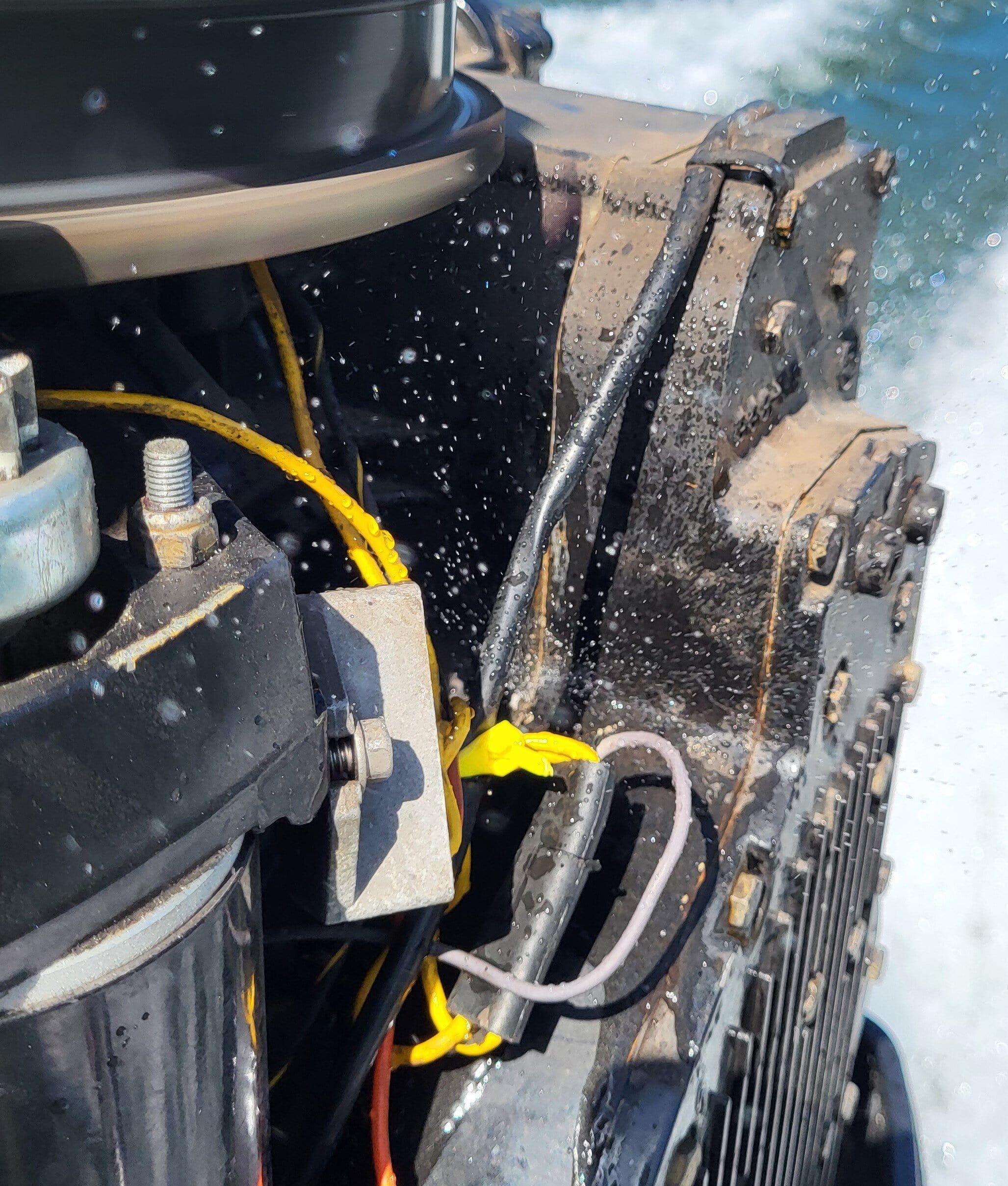

Thanks Jerry. I found a wire for #5 from the stator that appeared to be broken so I replaced the terminal. Took it out again today to see if that was the issue, but the problem persists. While running it WOT, I watched the engine (as much as I could while still steering the boat) and saw that there was water squirting from the exhaust manifold. It doesn't appear to be doing it at lower RPMS. Is it possible that water could be going into the cylinders at WOT from a bad gasket and causing my problems? Or water going under the flywheel to the trigger and stator and causing the problem? I attached a picture of where the leak is at. Hopefully it shows up. A little difficult to do while driving the boat.
Picture of the exhaust leak location
Pull the plugs and inspect.
Had that problem, yet had 145# comp on all 3 cyl. TINY!!! little pin hole in the head gasket causing a miss.
Try tightening the bolts closest to the leak??? Not helping? Then pull the head and replace the gasket.
Salt water motor? Head removal can be very difficult. Bolts seizing and breaking off :(
