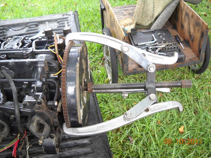

I have a force 1989 Force 125 Inboard/Ouboard.
It will only start or idle if I manually move the throttle by a very small amount.
Such a small amount in fact, that if I shove a playing card in the space between the Cam Throttle and the screw at the end of the linkage, it will start and stay running.
Sorry for the poor description. I hope I'm using the correct terms I have attached a picture with the area circled in yellow.
When I have the throttle open a little, it starts immediately, without any issues and sounds great.
I can actually manually rev the throttle and it still sounds good, I just cannot get it to start as is.
It is worth metioning that it has sat in storage for 4-5 years without starting, and ran fine when it was put away.
All the old gas evaporated, so I'm wondering if a good place to start is cleaning the carbs?
Any advice would be highly appreciated.
