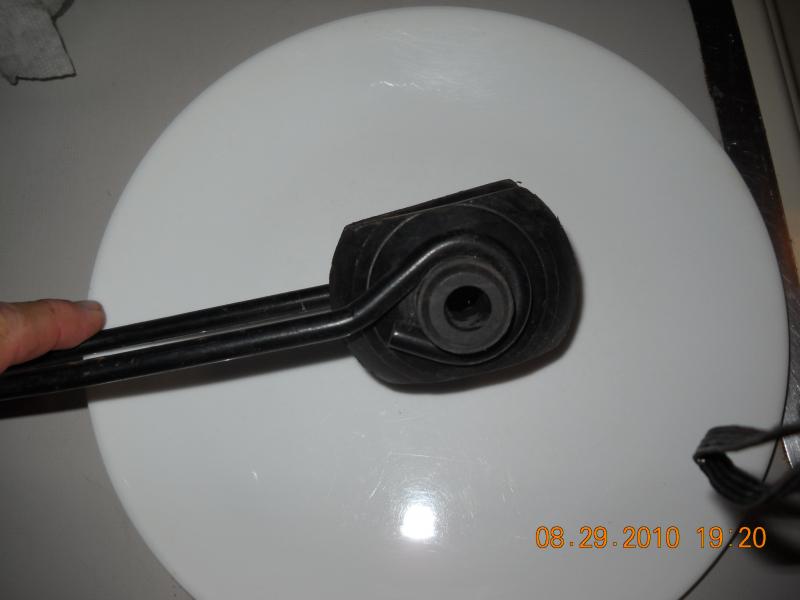

The muffs for your 50 are different than ones that fit the bigger motors.
