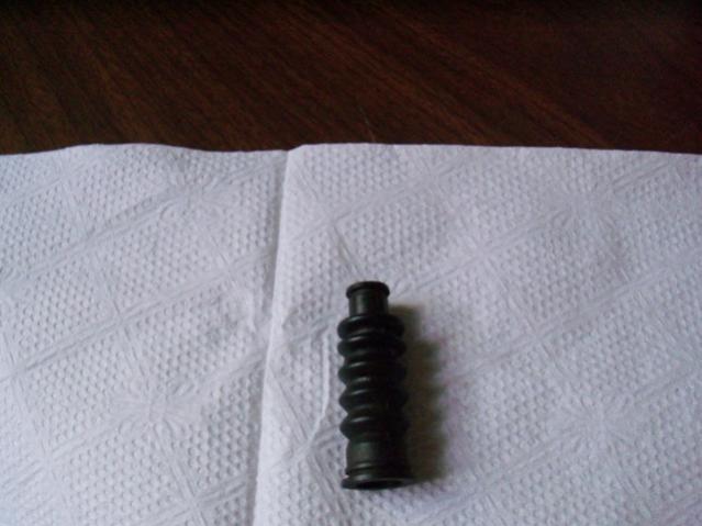

Attached part was sticking out where the shift shaft goes.
Where should its final resting spot be, way up on the shaft, or down low?

Looks like the boot for the lower shift shaft on a Mariner. On a Mariner it goes on the lower shift shaft, down inside the well in the LU where the shift shaft cam is inserted. It's installed on the lower shift shaft and pushed down into place as the lower shift shaft is inserted into the LU. If it's not a Mariner, I don't know.
