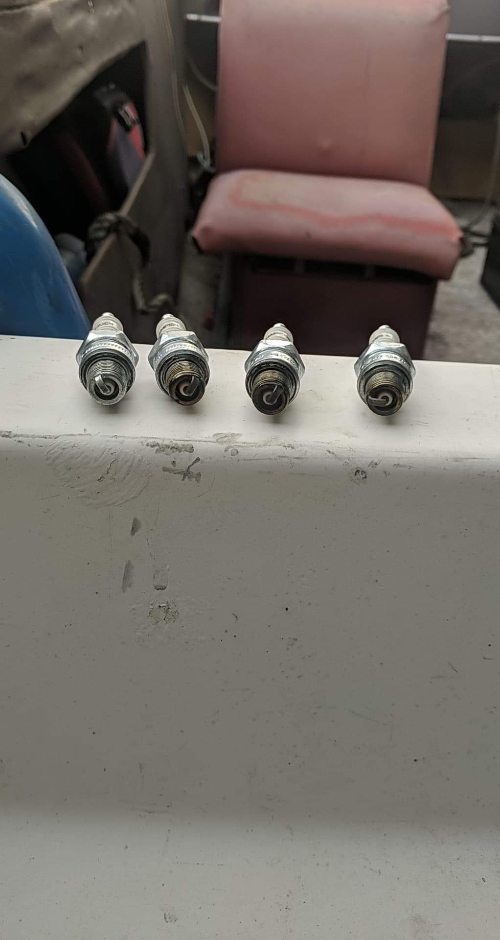

I had it out in the water last week. Wouldn’t break 29mph on my 18ft boat. Should be reaching around 40mph. Felt very low on torque. Ran it around the lake for about an hour then pulled it up on the trailer. 3 spark plugs looked normal and 1 (bottom port side) looked very clean, as if it was brand new. (I had just replaced the plugs and gapped at 0.040).
Not 100% positive but sounds like an intermittent misfire. Coils, spark plugs and spark plug wires are all capable of causing an intermittent misfires. Consider swapping coils/wire and plug (as a unit) between two cylinders and see if the problem moves. It likely will. If so then you can narrow it down to one of those 3 components.

Took it out again today. Same thing, one plug super clean. I hit the choke at WOT and it made the rooms jump way up. Taking the carbs apart again. received_427131201924622.jpeg
Stop running this motor and look for the " smoking gun "-----If a carburetor is blocked ( high speed jet ) then you starve one cylinder of oil as well.-----Motor will go ---" boom " on you.
Took the carbs back apart and found a bit of paper towel from cleanup plugging a jet. Got it all back together and in the water. I'm making about 33mph on my 18ft boat. Sounds very good and gets up and goes good. I looked at the plugs and the port bottom side is still very clean as if it hasn't been run... It looked a bit wet, cylinder has 115+ compression. I couldn't imagine it could be a head gasket leak with those compression numbers. Any thoughts?received_427131201924622.jpeg
Glad to hear it's running good now. I would run it some more before making any judgements about the spark plug. Might just take a little more time for the plug to show signs of combustion.
