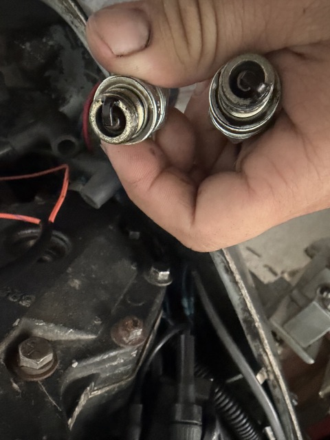

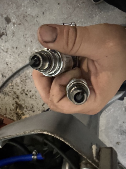

Update I replaced the reeds with Chris Carson sport reads and all new gaskets , used a bore scope down cylinders and pistons and walls look good , plugs are all black and wet , took boat out today and no change , disconnected voltage regulator and no change , I feel like spark is not advancing I may have gotten bad timer base .
Plugs
The spark advance is by the timer base rotating as the throttle is advanced.
Either it works or it doesn't as far as producing spark. When it sparks (as in timing) is mechanical linkage.
