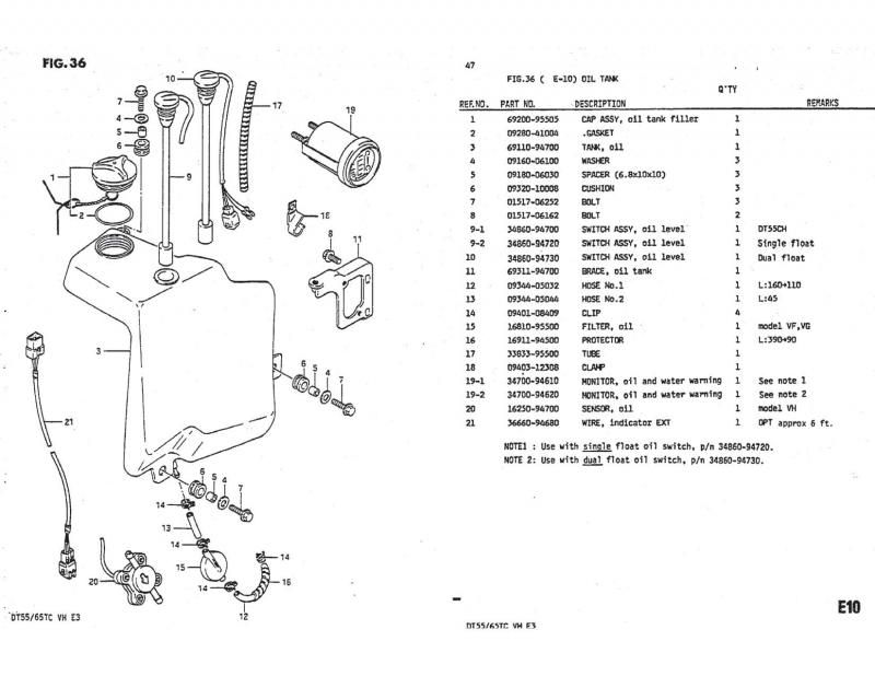

Hello all i have a 1987 DT55 Suzuki motor. i want to disconect the oil injection correctly, has anyone done this. I read alot post everyone refers to brownpoint well with sandy they are gone now.
From what i gathered do i just remove the tank oiltank.jpg And any wires leading to it? im just scared it will fail
mix gas and oil at 50:1 --------Just feed the discharge of the pump to the intake line of the oil pump.----Just a bit of plumbing and easy to convert should you want to market / sell the motor.
You are making this to be more difficult / involved than it is !!------Post #3 has the information that you should follow.-------Nothing more needs to be done at all.-----------Keep enuff oil in the tank so that alarm does not come in.
Oh man i get it know that is pretty simple thanks so much
