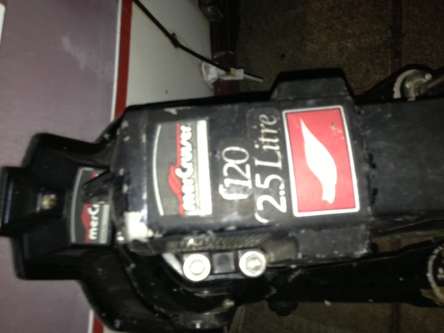

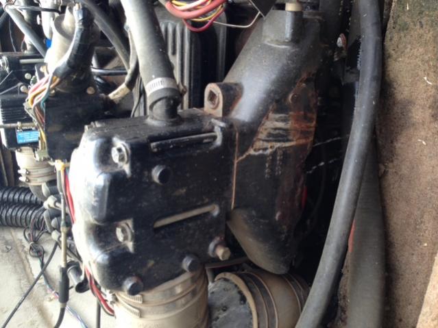

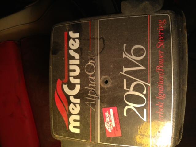

Fact 1. the lower half of the outdrive (lower unit) is interchangable and has no affect on gear ratio.
Fact 2. your Upper half (upper gear housing) clearly shows 120, 120 means 4 cyclinder motor. as stated the upper gear case gear ratio for a 4 cylinder motor is different from a upper gear case for a V6.
IF you do not have to purchase this boat (as no one should ) then I would say spend all the money and time you want to restoring it.
When you get to the out drive you can run the boat as is, just be prepaired to controll rpms and not go over 4800 rpms.
