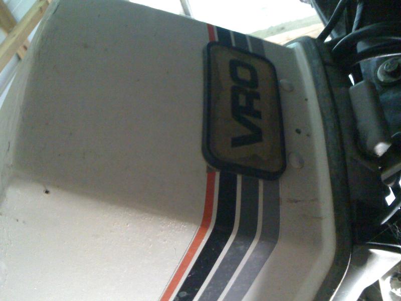

So , the cylinder condition is good !---------Now check that you have spark on each cylinder that will jump a gap of 7/16" and with a snap that you can hear !-------If that is good look for fuel issues such as fuel pump / carburetor / throttle synchronization / crankcase compression / reed valves / leaking fittings .-----------------Is this motor running with the VRO as a fuel pump only or hooked up for automatic mixing.----------------Post picture of motor cowling , that will get the year to order part as these motors were common for many years.
this is my motor, the VRO has been took off, years ago before i bought it.

Motor is a 1985 based on the graphics of the cover.-------------Very little goes wrong in the carburetors.----------------------Go to --------------shop.evinrude.com -------------for all the parts you would need.---------------------Or at the top of this page where it says --------------motor parts.
