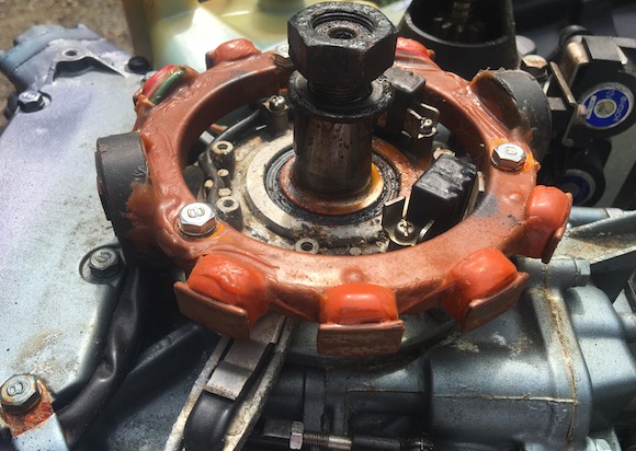

Removed flywheel and found lots of corrosion under there.

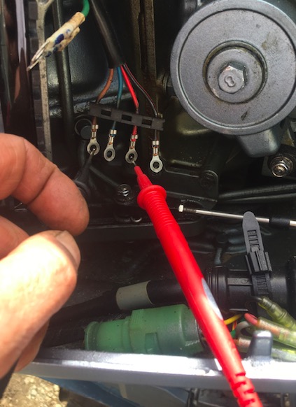

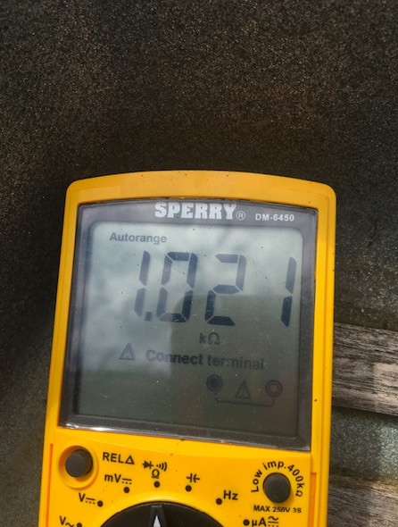

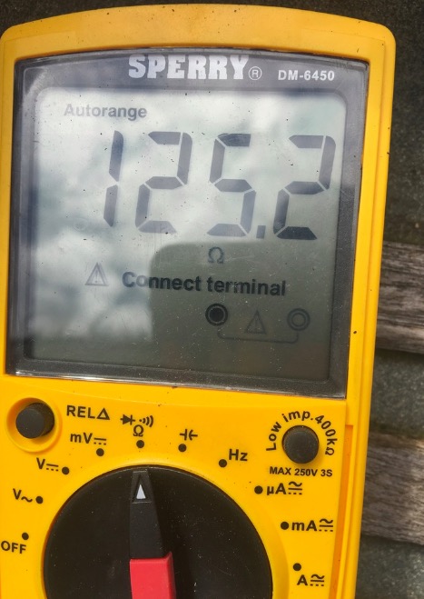

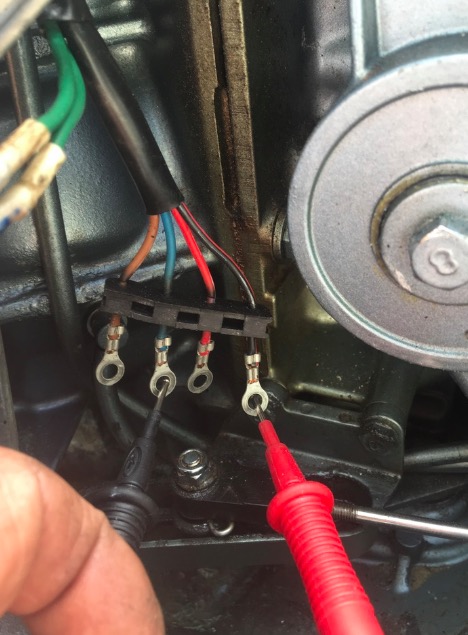

Here are the Ohms readings from the stator:
Brown to red = 1020 Ohms
Blue to Blackred= 125.2 Ohms
Green to Green (charging coil)= 0.3 ohms
Trigger:
white red to white yellow = 341.6 ohms
white black to white green= 341.1 ohms.
What do you think of the readings of the stator? Seems to be pretty off.
Would a bad stator alone gives the symptoms I am getting?
Also, RPM gauge acting up could come from either stator charging coil or rectifier, right?
