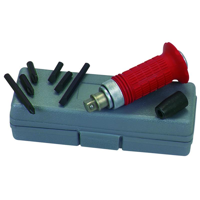

As a last resort an impact driver and dead blow hammer could help or hurt you. Used these on cycle case cover screws quite a bit......
Daves69 That's a great tool but on an outboard that's been in salt water, NOOOO
That tool has so much torque that it would twist off every screw or bolt.
