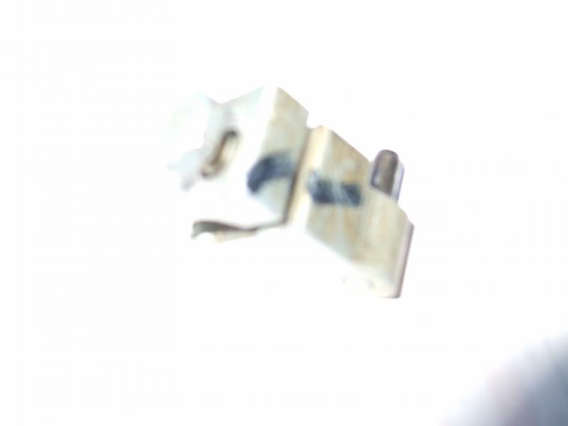

hi again thanks for your info, ive taken out the starter motor and i can see that bolt it is a bit hard to get at. it seems to be on a clamp thet pushes the shift leaver up and down does the bolt have to come right out or just loosened and slide the clamp out,or how does it come out thanks again
There is a special bolt / pin that goes through the shift rod and it must be taken out.----------Look at this carefully as you can easily try to take out the bolt from a clamp and that is wrong.-------No clamp needs to slide out !
hi again regarding the removal of the shift lever there was only the clamp bolt i removed this bolt and the bracket slid out freeing the shift leaver it had pin whch went into the hole in the shift lever so everything is sorted out i apprecate all your help thank you all
