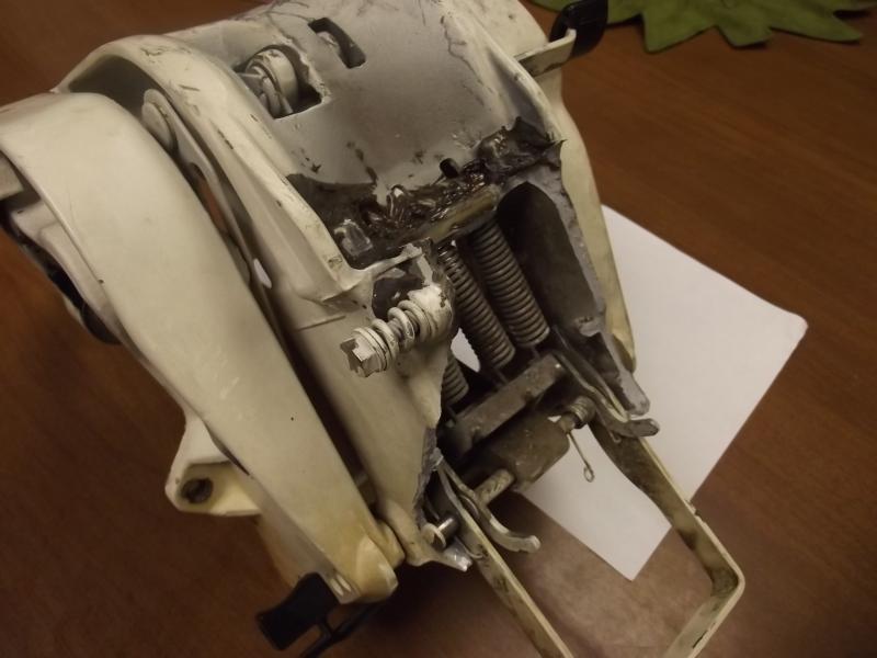

Had an accident backing into parking and broke swivel bracket. (0330507). I can find no refrence in seloc manual on repair procedure. Is there any info out there?? (Besides driving school suggestions)...thanks in advance !
DSCF1077.jpgThanks for the reply...it's a J10ELCDB SER# E6165123. I found a 0330507 bracket with 394211 steering bracket and 393190 clamp assy on ebay..should be here monday...here's a pic of the broken pc
Yeah, I really screwed this up...It's strange that neither the seloc or the "official" johnson repair manual that covers all 1.25 - 60 hp 1971 - 1989 has any info on the midsection, or at least I cant find it if it's there..I dont want to do a lot of disassembly that isn't necessary or do something in the wrong sequence
THANKS FOR THE TIP !!! Got it all disassembled and reinstalled the "new" swivel bracket. will try to peddle the other parts that came with it on ebay. cudos to you & leroy!!!
