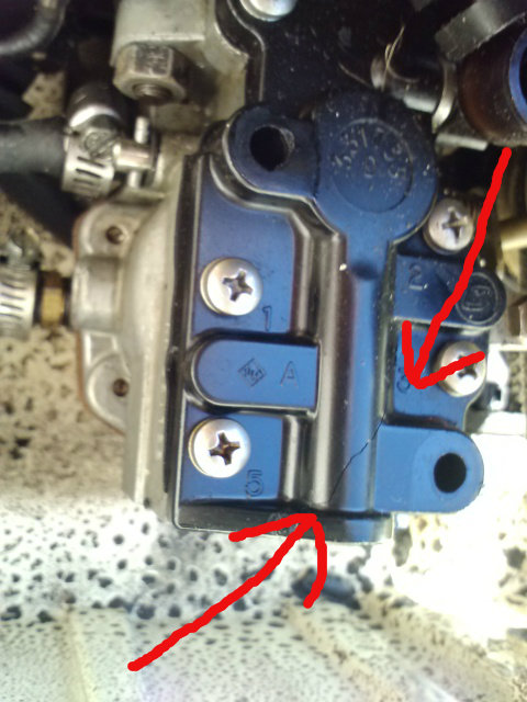

2) The carb top is a plastic body that was previously cracked when I got it from someone torquing the screws down too hard. I am not sure if this is effecting it or not, the crack appears to make it's way down into the air jet screw.
Here is the crack. Since this pic, I've covered it with epoxy (cleaned it with lacquer thinner and scuffed gently with sandpaper to make sure it stuck).
This is an obsolete part, any suggestions on where to find one? All the common parts places I've seen online list it as "obsolete".
