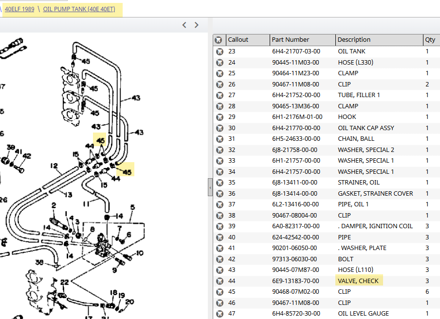

Rebuilt the engine this winter and it works wonderfully! I ended up replacing the oil pump and all the lines. I used a tygon yellow line and I notice after sitting for a few days, the oil leaks down almost to the pump on all the lines. Could I put a check valve in each line to hold the oil closer to the cylinder on start up? The oil pumps are hard to find and still used. Unless they can be rebuilt?
Check valves were implemented starting with the 1989 40 HP models.
I can think or no reason why you can not retrofit your model with the later check valves.
