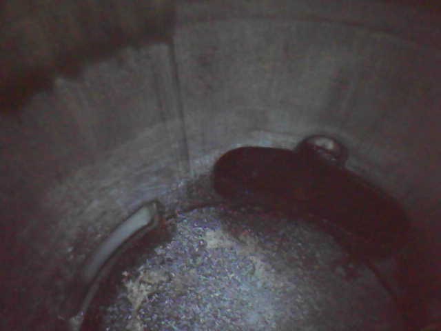

Just checked the compression after a heavy decrab with sea foam. Warm and wet it’s reading around 80 on both. I used a endoscopic camera. The cylinder walls don’t look bad. Some small scoring on the side walls but I don't see any significant damage.

Is compression my problem ?

Thanks. That’s what I am leaning towards. Doing one more Seafoam decarb as a Hail Mary. Sort of hoping the rings are gunked up and not seating like they should. Probably wishful thinking.
