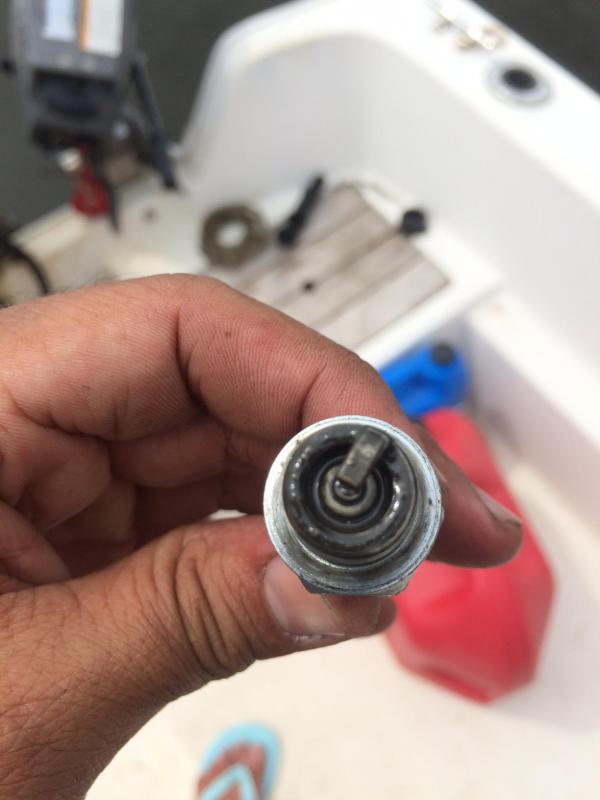

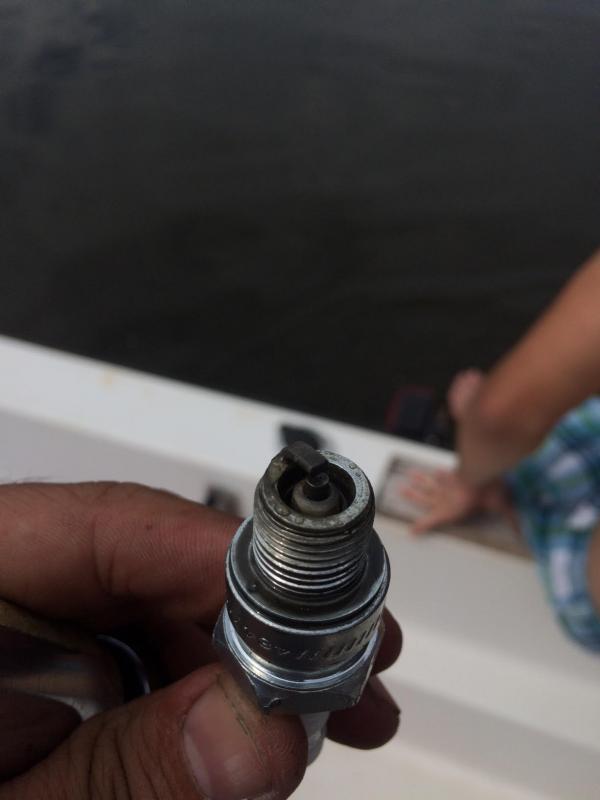

After pulling the new spark plugs (QL77JC4 gapped to 0.4) I notice fluid on two of them (Bottom left cylinder and one from the right head, maybe the bottom one). One is badly gunked up and the other had droplets. If you have seen this before let me know. I don't want to assume water even though that is what I think it might be.
