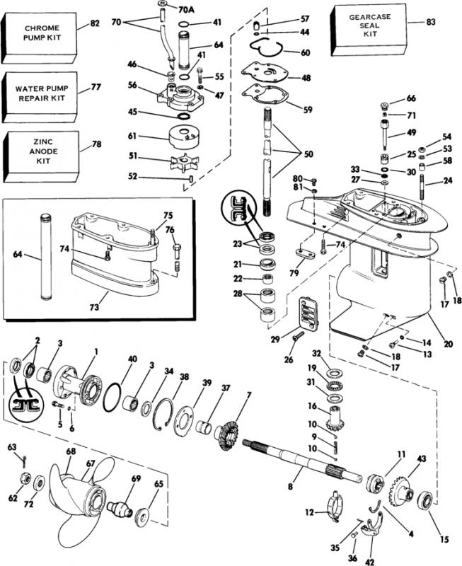

After being able to spend a little more time looking and learning more about this engine it appears that the part number labeled#64 is missing. What is the Spacer needed for? (yes, I’m going to replace it,just curious about its function)
Also, I removed the Water Tube (#70) but I’m not sure if the washer is still up in there or not, but it appears that it is not a part that is available anymore. Anyone ever used an O-ring before?

After being able to spend a little more time looking andlearning a little more about this engine it appears that the part number labeled#64 is missing. What is the Spacer needed for? (yes, I’m going to replace it,just curious about its function)
Just asked the same question when replacing water pump on my 89 Johnson 20 hp, here is one of our experts' response:
Keeps water from shooting up the driveshaft tube and away from the bottom main bearing seal etc.

After even more looking around this driveshaft is stampedwith 323261 and measures 25 3/4" but based off the info using my modelnumber the drive shaft should be 341636. When I googled the 341636 to see if Ihad any options of buy one (Marine Engine says they are not available) I foundseveral on eBay but they measure 24 1/8” long..... So there is huge differencebetween the two.
I found that I can still get the 323261 from MarineEngine if I had to go that route… Just food for thought. I’m assuming thislower unit has been replaced with a different unit? That part number alsobrought up a 1982 35hp Evinrude diagram when I did a quick search.
