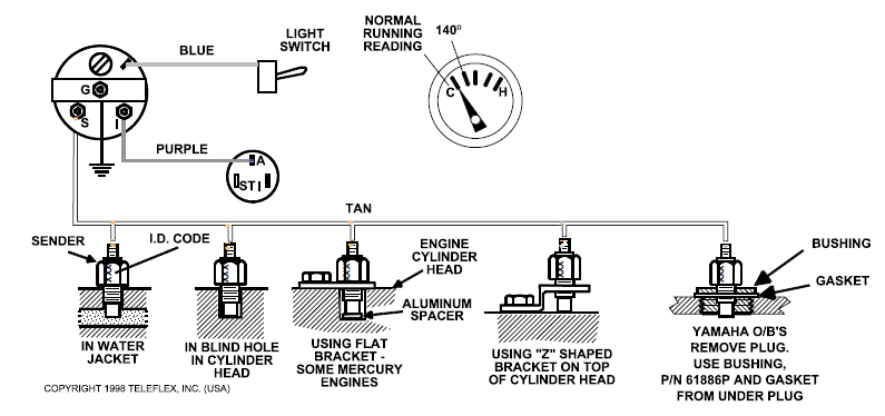

I have a great running old Mercury 150 Black Max I would like to install a water temp sensor in. I currently have an alarm, but want to be able to see the actual water temp of the motor. I am not sure where on the motor I can install a sensor.
Thank you for any help
Are there no plugs in the cylinder head into which a sensor can be screwed?
An alternative is to mount the sensor on the cylinder head so that water temperature is read but somewhat indirectly.
