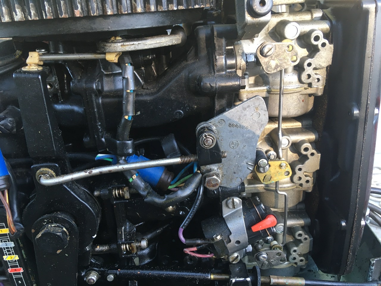

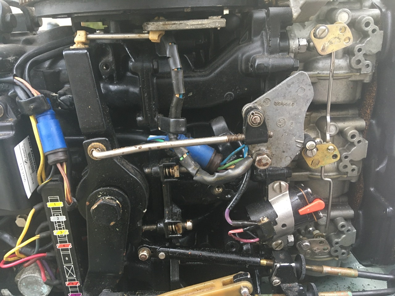

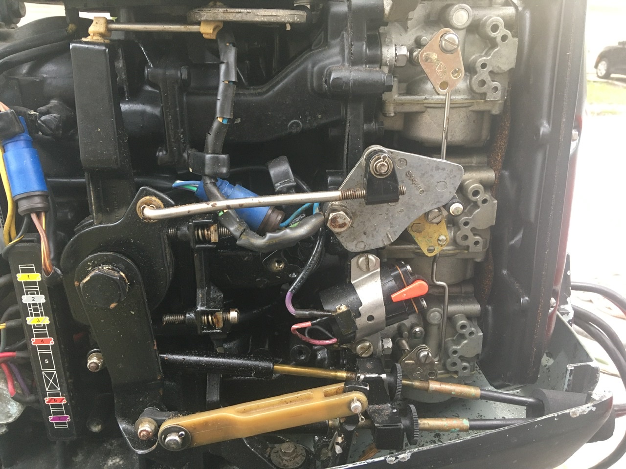

I most certainly respect your opinion as you have likely forgotten more about this motor than I care to ever learn. These are from throttle alone and I touched nothing. The following picture is wot returned to neutral, I have not touched it at this point. If I’m not mistaken, that SHOULD have traveled back to the mark. Is that correct?
You need to adjust that black " wheel " on the cable to slow the motor down.----Turn it one way will be wrong.---Turn it the other way will be correct.
10-4. That was my thought and the adjustments made to get to fully open the carbs. Lost the ability to shift into neutral, and idle rpms went way too high, so i went back to where I started which was far better than my adjustment.
This is shift into/out of gear properly, idle in neutral at 12/1300, 8/900 in gear, top end is 4200 (this is now a confirmed a prop issue). I was not sure if it was a prop issue or carb butterflies not fully open issue previously.
If after adjusting cable as Racer requested it still does not come back to idle stop screw you need to inspect control box.
Didn’t get a chance to disconnect cables, but I know I adjusted one thing and one thing only, so put it back where it was. Pics in following order are WOT, then back to idle...comes to roughly 1/64-1/32” of idle stop. Probably a 1/4-1/2 turn on the screw if I were to adjust it.
