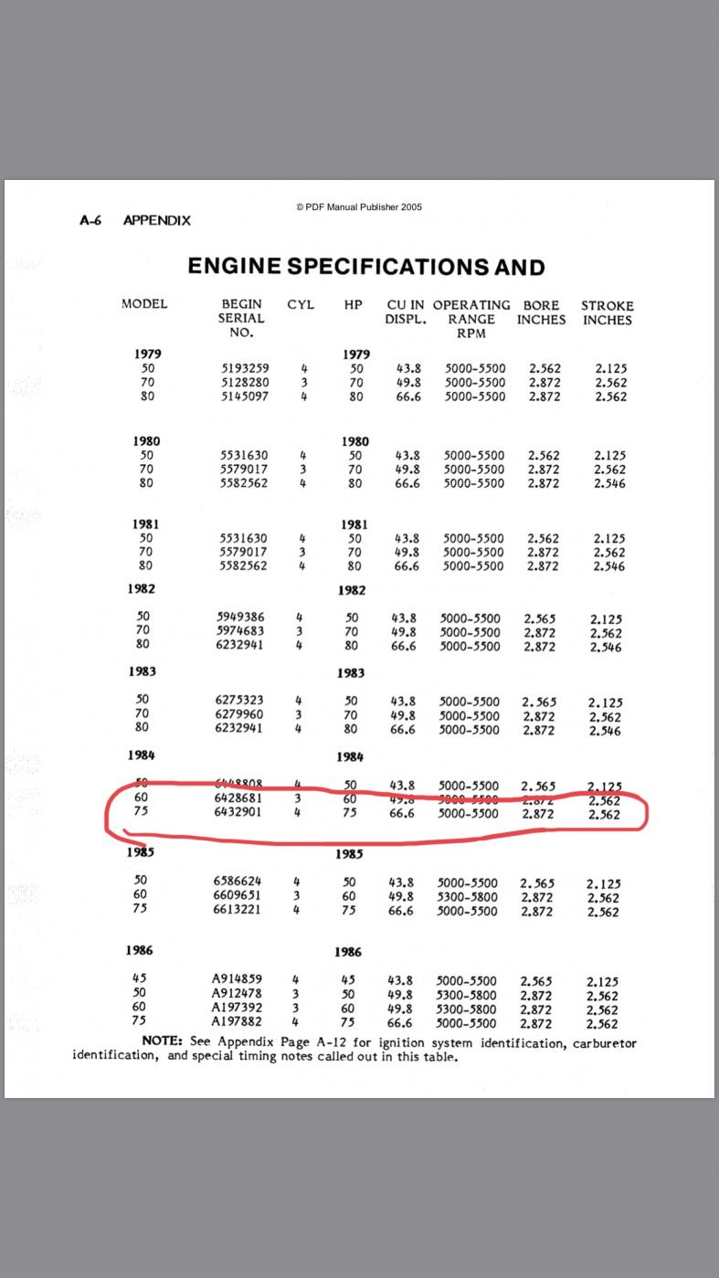

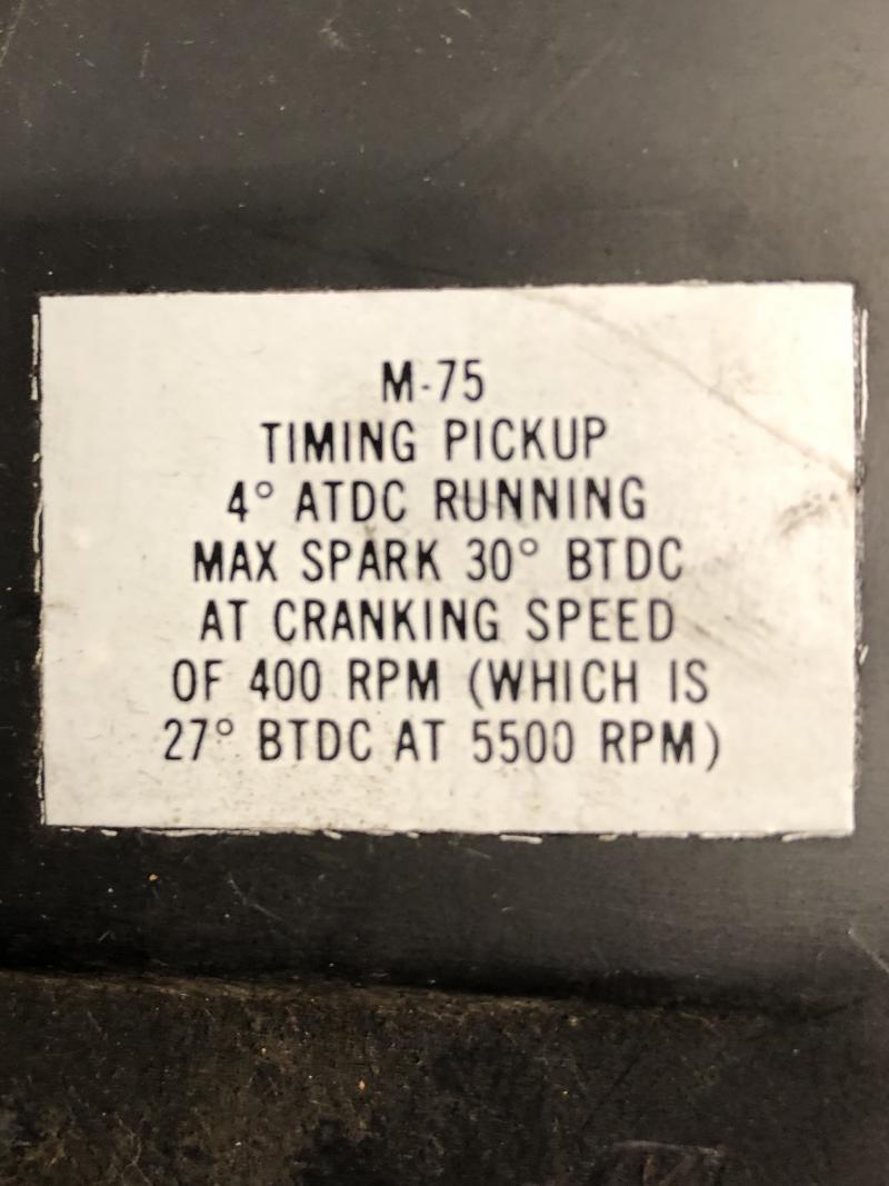

I’m off to the lake tomorrow where my dad is so we can play around with this thing in a proper body of water. I’m at the link and sync stage and here is where I hit a bump with info. The factory manual tells me the primary pickup should be set at 7-9 deg BTDC and max timing at 23 BTDC. However a sticker on the cowl silencer cover says that pickup is 4 ATDC and max at 27BTDC. I’ve read in a few places about setting max back a few degrees due to fuel quality and whatnot but not sure what to do about the primary pickup. I also understand primary should be done in the water, forward gear idling.
