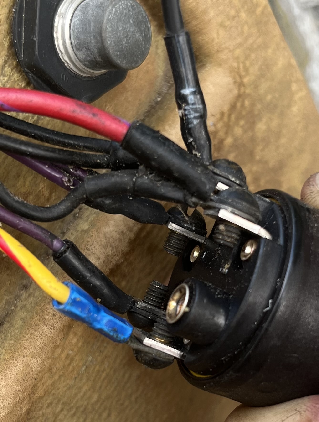

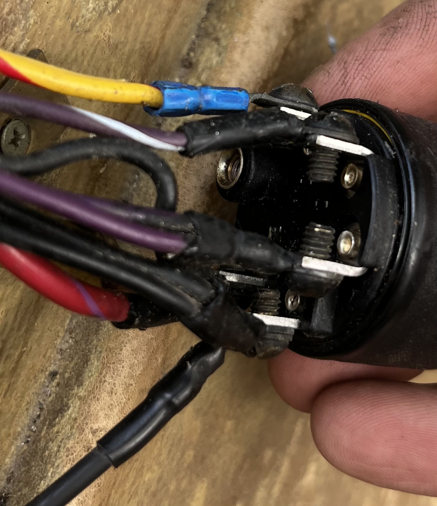

1984 key
Says 320 on the key switch
Not sure it’s wired correctly either

If it's an OMC switch there will be a 2 digit number WHERE THE KEY GOES ON, not on the body of the switch. The number will be in the 50s to the low 70s.
Yes, sorry, Droid‘s info is also very helpful to know here where at all possible as the manufacturer make of the switch could help locate a key thats already been cut to where if the switch was/is OMC/Johnson, etc. of the 1984 era, the key series number ought to be a 77 series using the following info from this website Marine Engine . Com…, Johnson Evinrude ignition keys are used with push-to-choke ignition switches, and fit both remote control boxes and in-dash switches. 77 series switches had a black nylon flange in the switch where the key was inserted.,
That mentioned, while I’m not finding exact match’s to a 320 number for marine type use, there appears to be cuts for the 320 series out there for other brands, etc. from a site I’ve used before with success that may be worth reaching out too as well.
See any other markings anywhere else on the switch?
Might be easier going with a new switch and key set up… this site would be a good place to buy one if desired.
