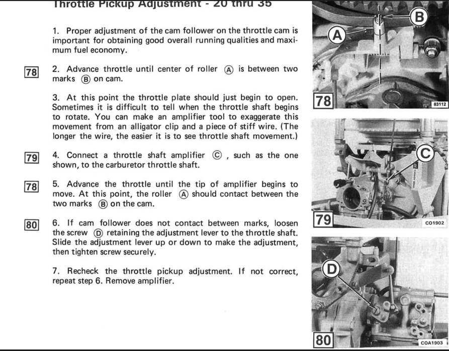

I am trying to set the "Throttle Pickup Adjustment" and "Throttle Control Rod Adjustment" according to the OMC manual. However, these settings seem to contradict each other. I really feel like I am missing something or misinterpreting the instructions. I am using the throttle control rod set screw/nylon block to make my adjustments. The manual states to use the adjusting screw on the lever where the throttle connects to the carb. That makes sense if the follower is not contacting the cam, but I don't see how that would affect lining up the cam follower with the marks as the carb begins to open.

OMC instructions I'm working off of:

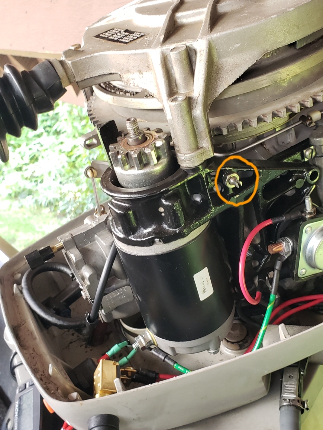

Looks like the spark advance stop bolt also serves as the high speed throttle stop. (feel free to correct me if I am wrong on that) Duh. Looking back, it should've been obvious, but with my inexperience it didn't click right away.
(I was confusing the throttle lever itself contacting the engine block with the throttle/timing cam contacting the spark advance stop bolt as the high speed throttle stop)

I have the same issue you describe but I did not understand what the solution was. Where is the spark advance stop?

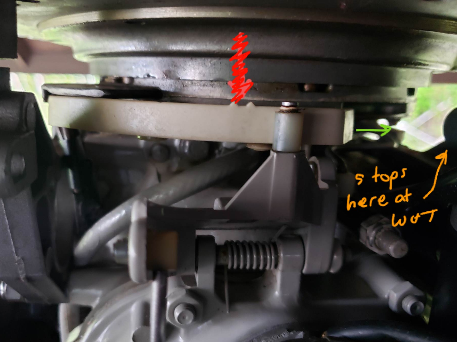

The throttle lever doesn't hit the engine block. At WOT the timing plate should contact the spark advance stop bolt. IIRC mine had a rubber stopper on the end of it. Tried to show it below, mine adjusted with a lock nut on the back side.
