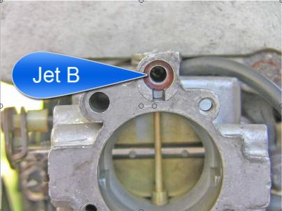

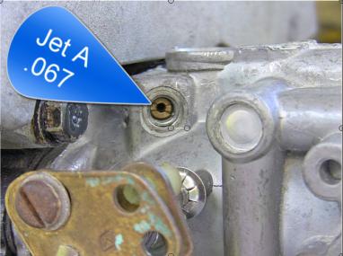

I am just about ready to deep six the thing. I noticed that one of your guys mentioned something about drill out the jets about .002. I have attached a few pictures.
Which jet shown in the pictures needs to be enlarged to get better transition from idle to WOT?

I checked all of the Jets on the side of the carb (Intermediate Jets) per your information and they all have a .067 jet size. Saying that the hight speed jets are clean would enlarging the .067 intermediate jet size (i.e. .070 next number drill size) allow more fuel to enter the engine and provide a richer mixture at the intermediate level of acceleration?

I wonder if anyone here can tell me what the actual orfice hole sizes are on the jets you referenced. I checked the intermediate orfice hole size and it is .067. Just wonder if the orfices the marina installed were the correct size or maybe an oversized or undersized orfice. I have the instruments to measure them.

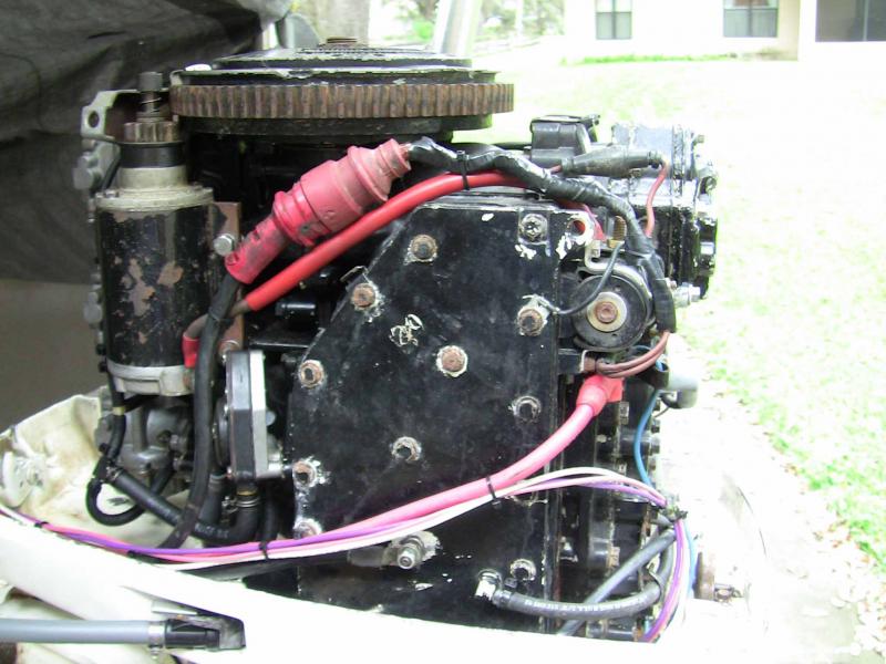

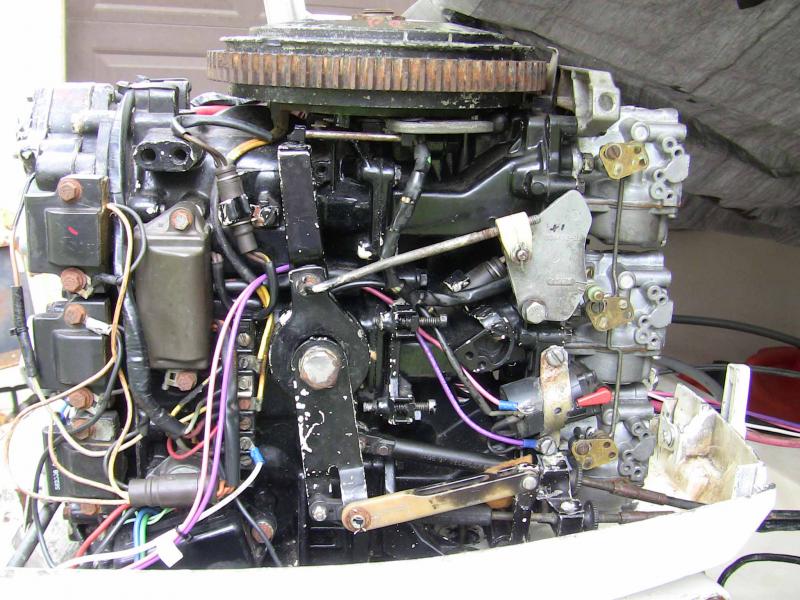

Hi,
Here a few pictures of the powerhead.
John
