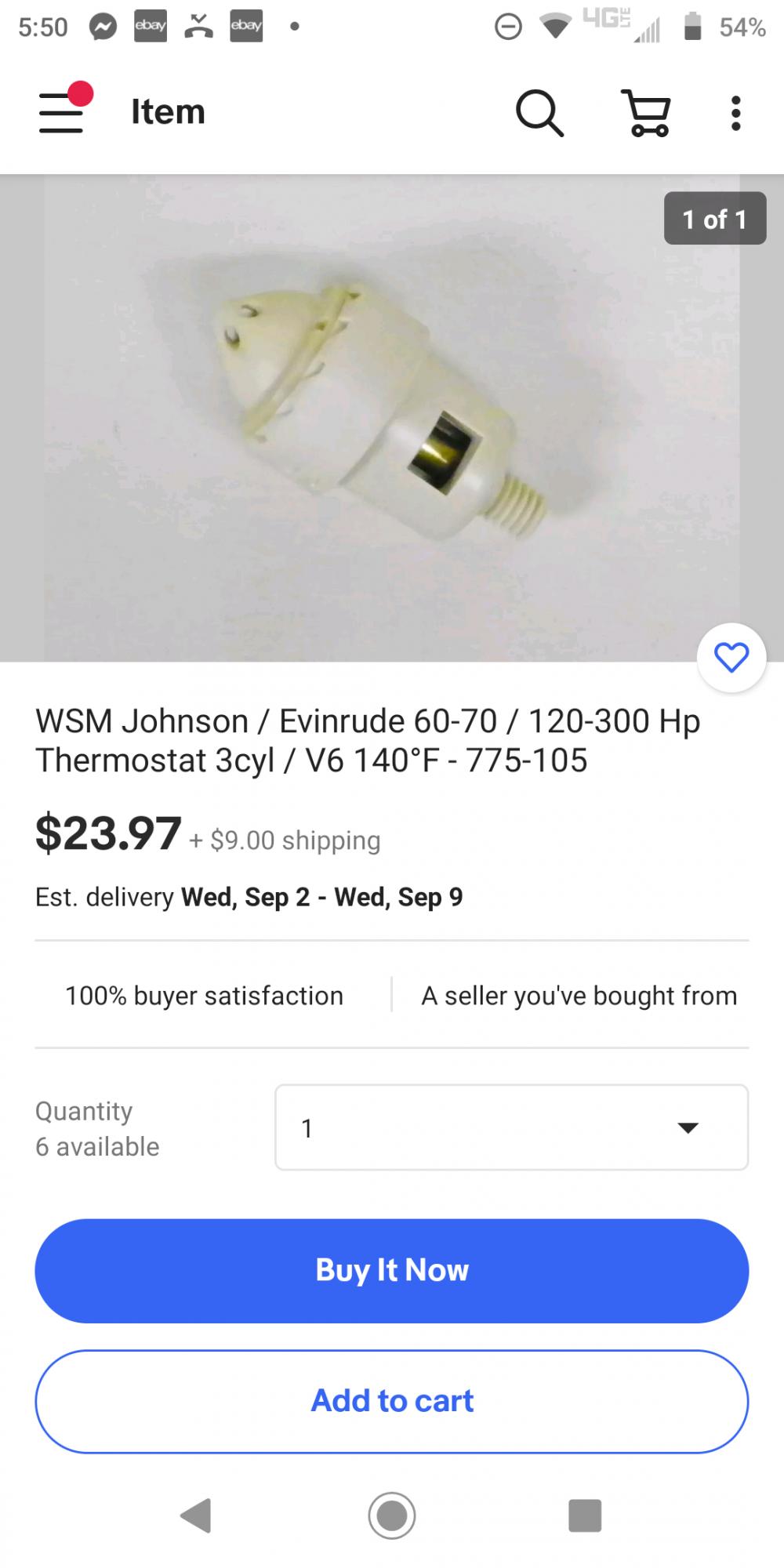

Right.....here is the masterful engineering that I throw in the woods.....as far as I can.....behind my shop. Think they showed up around 1986.
Exactly WHAT is the problem with the plastic thermostats? Thousands of them out there that seem to work okay. Racer HOW would you improve the 56 cid set-up?
