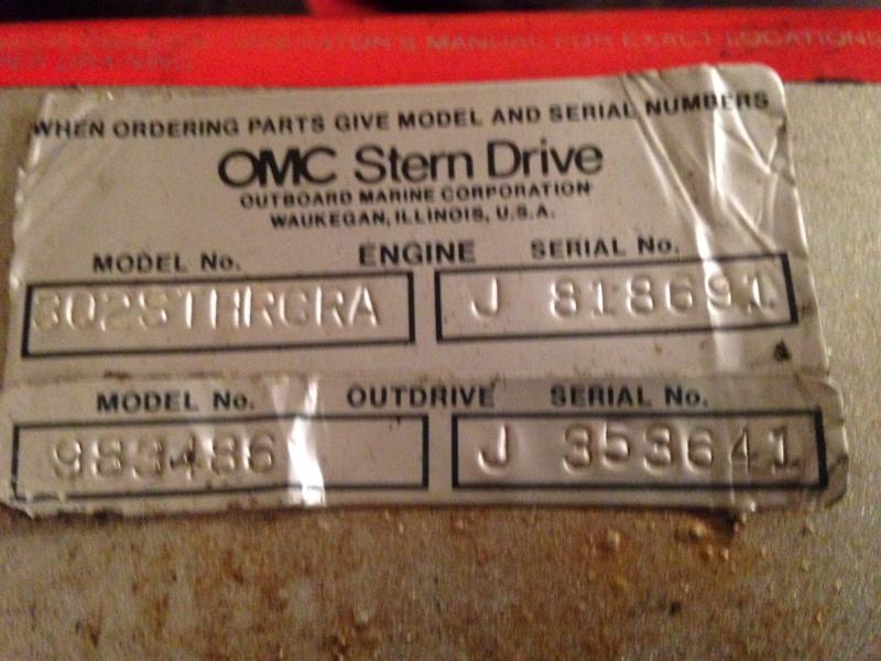

Here is what I have: 1984 OMC Sterndrive 181 140hp 3.0L GM 4 cyl. The Boat had been sitting for about 2 years when I got it. The boat started but ran rough. It sat for another year and then I started working on it.
Here is what I have done to it: I took the engine all the way down to the block, I left the crank shaft and pistons in the block. The engine block and head surfaces were in spec with no sign of warping. I replaced all the gaskets on the engine. I also replaced the Battery, Fuel pump, starter, starter solenoid, Distributor cap and rotor, Plugs, wires. I tested the exhaust manifold of leaks.
The problem: The engine turns just fine (but seems different to me). I posted a video so you can see and hear what it sounds like. I have already checked the spark with a timing light and also by holding the plug near the plug. I have bright white spark from all wires and the coil wire. I checked the fuel flow and have gas in the carburetor like I should. I rented a compression gauge. I have no compression in any of the cylinders. Although it wouldn't be the first time I rented a tool and it didn't work Properly. I did test a cylinder on my truck and got nothing as well. I'm guessing it's the gauge. My oil pressure Gauge on the boat says I have 35-40 lbs of pressure while cranking it. I have 1/2 tank of gas. The boat has 545 hours on the engine. I have a rebuilt Rochester 2 barrel carburetor. All 5 Solenoids Tested good, and all fuses are good as well. I am out of ideas, any advice would help.
