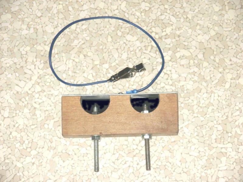

Hook up a spark tester at BOTH cyl's.
Unscrew the plugs, pull the cord.
Sparks should go 1-2-1-2......
My guess you have either a dead cyl, or a cyl that double fires. (2 cyl's at the same time)
If so, change the power pack.
At the same time do a compression test, both cyl's within 10% of each other.
If you do not have a tester, make one:
