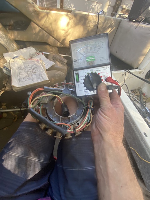

Ok I’ve taken the stator and trigger off using my cheap multi tester from the stator I get no readings from blue to yellow or blue to blue or any reading to ground, I do get it to peg when going green to green. I happen to have an extra from a parts motor I picked up and get the same readings from that one
From the trigger with my meter set at rx1 ohm I get from orange to green 45 on both sets nothing from green to green and nothing on orange to orange. From red to white with green stripe I get 50
So I guess both my stators are bad

will the meter I have pictured above work, I find it hard to believe that both CDI”s have gone out at the same time but also wonder if I could have two stators get the same readings, still tend to think the stator is to blame but it’s not a cheap tpart to replace just to find out that’s not the problem and I can’t seem to find a stock stator with the round plugs like mine I only see ones with single wire connections and I hate to cut into my wiring if that’s not the problem
That meter will do the basic readings.
Try the second stator, it might work??
