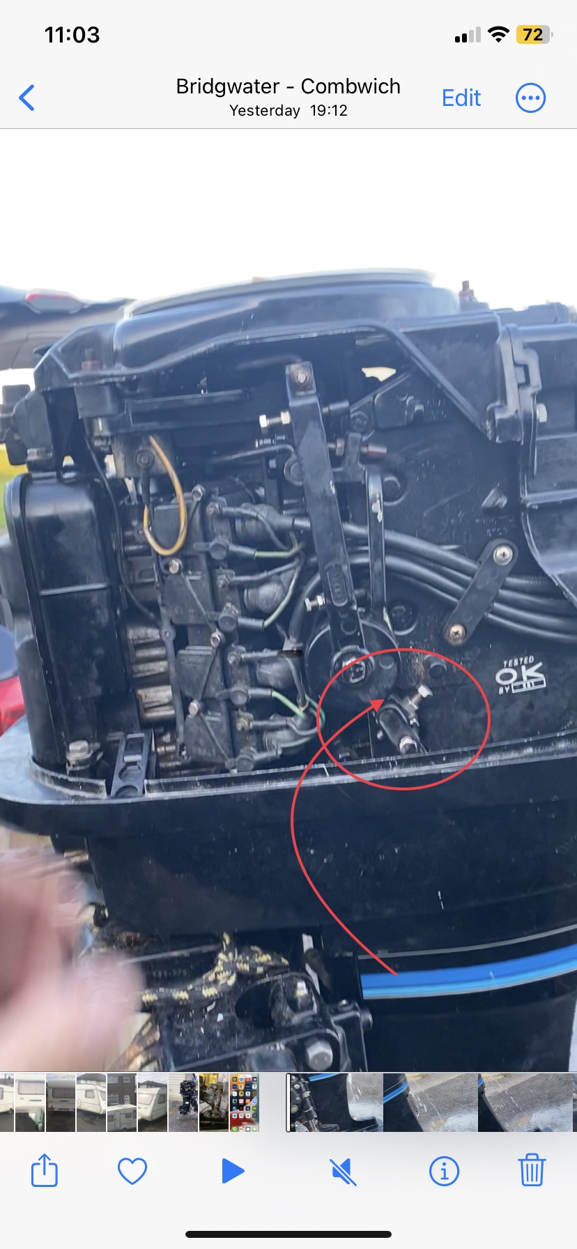

Mercury 80
The picture is taken with the controller in neutral
Should this be the position on the highlighted bolt and nut ???
Post the results of a compression test.-----It looks to me that someone has made adjustments in the hope of getting it to run better.----These arms and linkages rarely need adjustments during normal operation !!
