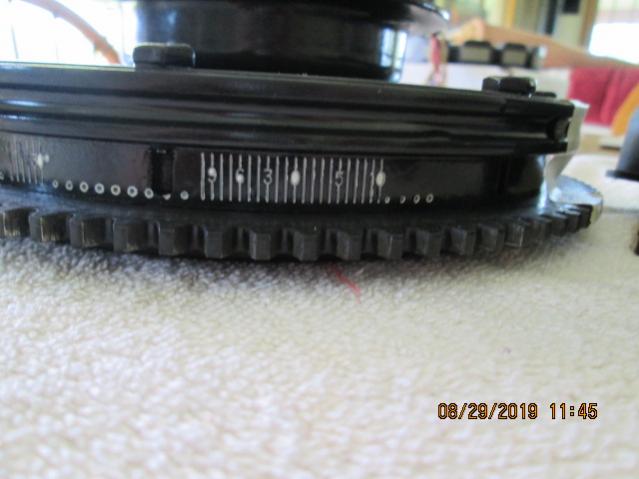

Fastjeff has the answer; sorry no help regarding a mark on your block; on my '92 Merc 40 4 cyl engine, timing marks are on the flywheel and the aligning mark is on a shroud that covers the flywheel; see pics:
