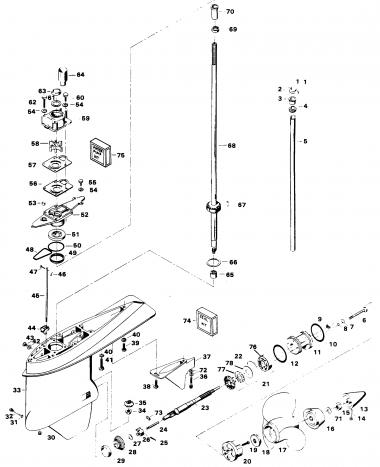

thankyou i did buy a manual and have started pulling the lower uint. i have the six bolts out and the cotter pin for the upper sleeve, but the lower unit is not coming loose. did i miss something or is it just stuck what is a good methed too pulling it out i appreciate any help you can give me. :)
Under the exhaust snout is another bolt.#39 24.jpgJ
