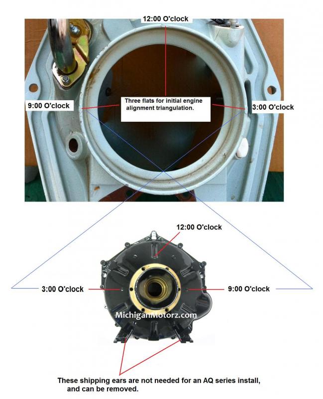

Whether side engine mounts are used, or if the engine is cantilever hung........ you will need to go through the triangulation alignment process.
There will be 3 flats on the flywheel cover that will correspond to 3 flats on the inner side of the transom shield.
These will be at 9:00 O'clock, 12:00 O'clock and at 3:00 O'clock positions.
You will rotate, raise, lower (in other words adjust) the engine position until you have an equal space between each pair of flats.
Don't forget that you will need to make sure that the exhaust manifold aligns with the down-tube.
You will do this while the clamping collar is just snug.
Once you have equal distance, you will tighten the 6 clamping collar bolts.

Here is an example of the 6 flats and how to adjust for equal distance between them.
This shows a later model V-8 flywheel cover, but the procedure is identical.
