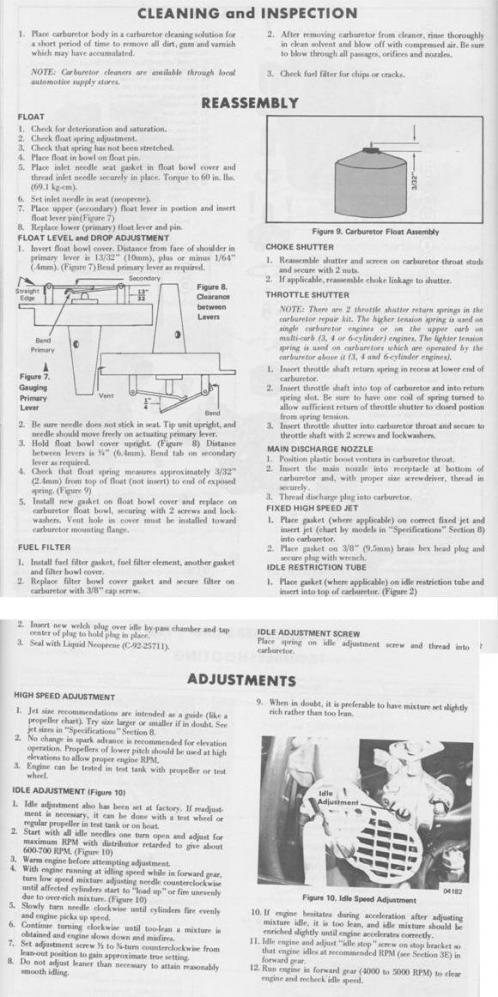

here is the carb, the other thing is the link and sync, the carb must open at the right time when the timing base stops moving.
