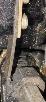

Another question. I’ve noticed my reverse lock isn’t working. I’m assuming the shaft should not slip in and out of the ball in the lock unit as mine is.
First course of action. You have a tilt pin in it? Is the tilt selector in troll (reverse lock doesn't work in troll). Is it adjusted correctly to where the reverse hooks are engaged enough to keep it from kicking up in reverse and neutral, but allow it to tilt in forward gear? It's a little finicky and needs TLC lubrication on pivot points. I have 7 of these 1 lunger engines but I have a mint 73' 4 hp that will only tilt up with the engine turned to port to tilt up, something with the little wire connected to the shift actuator . I lost interest in worrying about it. This motor can sit for 3 years and start on one pull so I'm good.
Currently there is no tilt pin and it is not in troll. I was just flicking between fwd and neutral seeing if there was any movement in the lock - there was not.
Then I noticed the wire moves in and out of the ball that is located in the lock unit as I move it back and fourth by hand.
