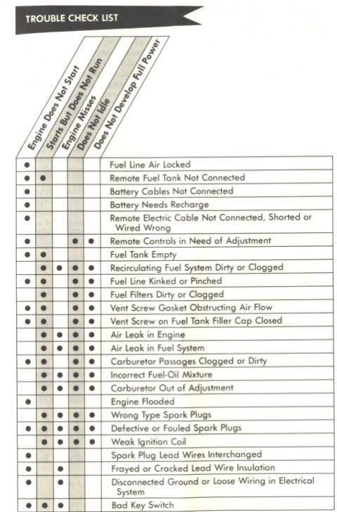

Just bought this boat a few weeks ago and only been out a couple of times and it worked great. But the last time I was on the water at full throttle the motor kept cutting in and out then it started happening going any speed but idling. I changed the plugs, gas, cleaned the carb.. Now it won't even start..Idk what to do.. Any help would be much appreciated.
