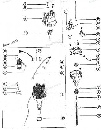

boat distributor.jpghere is a diagram of the distributor that I have on the engine! Thank You again for all of the help.
Ok now it is turning over but I am not getting any spark at the distributor. Wow this is getting to be a pain. LOL wish I could just get it up and running.
thank you kghost and bt doctur I am extremley appreciative for all of the help. lol can you guys help me figure out the no spark situation now Im sorry to be such a pain!
