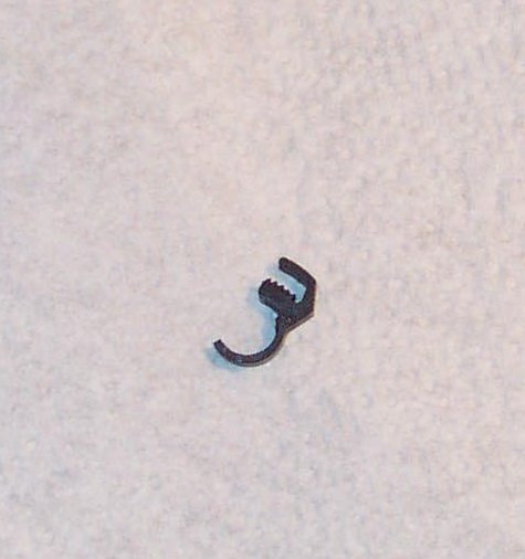

Rank n'file newbie here! Am thinking this clip, found at in the bottom of the boat is the kill switch clip and is needed to run the motor. Am I right?

No, that's just one portion of a broken fuel hose clamp. What kind of problem are you having?
