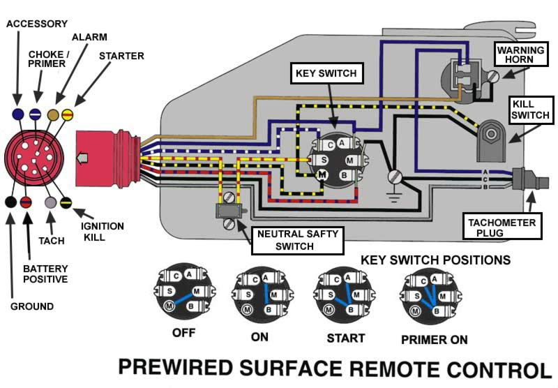

While attempting to start my 1980 Johnson 150 hp it stopped cranking like the battery was disconnected so i changed out that battery and still nothing so i checked for fuses and all were good the choke don't even click.
any ideas would be helpful
Check your Netural Safety Switch if its faulty it will not engage the starter or choke ...Disconnect the red plug and jump via solenoid if it cranks check the remote box as shown ...
