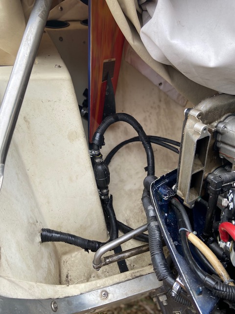

2. The in line Walmart Atwood brand fuel primer bulb was acting up and not pumping up hard even though it was only 2 years old. I found from searching the web and reading reviews, that Atwood primer bulbs are problem prone and only engine name brand bulbs should be trusted to last and bought. So I bought an evinrude bulb on ebay, works great so far.
ALSO I found from reading that the bulb Really should be mounted vertically so that they are pumped when vertical because their moving valves are aided by gravity AND if mounted vertical, this ward off the fuel from running back into the gas tank. It's nice having it mounted now so that I always grab at the same location to find and squeeze it. Pic attached.
3. I removed and thoroughly checked the 2 year old 3/8" gas fuel line hose and all connections and checked for any air leaks. I believe my fuel tank internal pick up flex tube that goes down into the gas, had a bit of an air leak at it's top attachment point which would allow the pump suction to pull in some air instead of gas. My 140 hp engine takes the 3/8" fuel line, smaller engines take 5/16" line.
