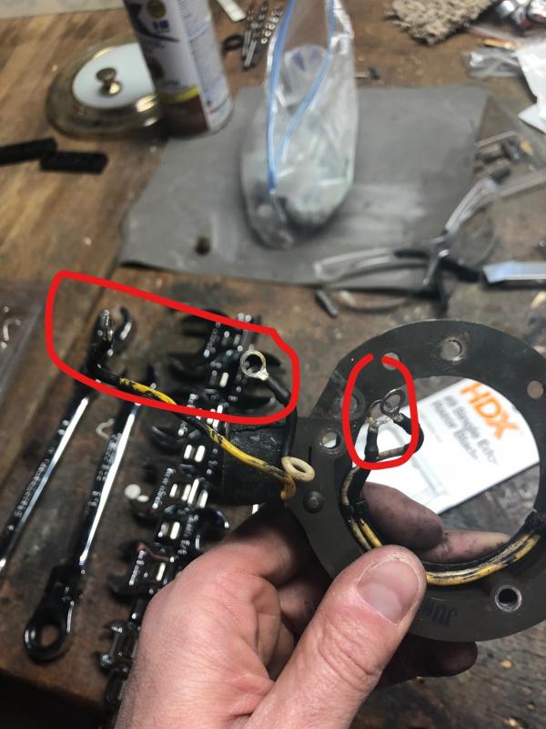

For the stator, I measured the leads in the picture below and they both report 835-840 ohms. I believe that is in spec, per this chart. http://www.outboardignition.com/page39.asp I haven't measured the trigger yet, I guess I'll have to cut the leads to the CDI to do so? (they feel like bullet connectors with shrink wrap over them)
