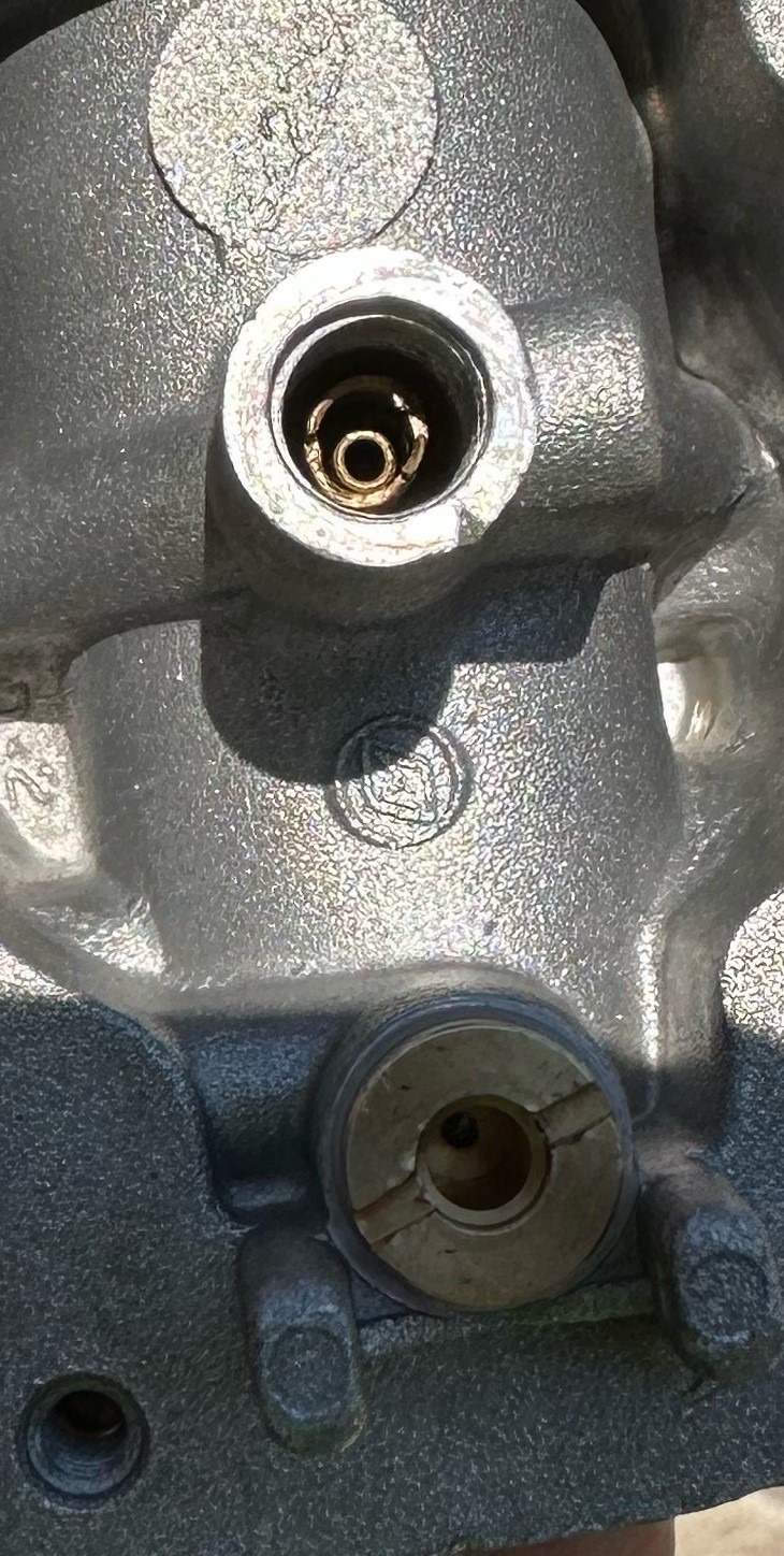

I recently pulled the carb myself. Found the damage evident in attached photo on the high speed jet/port. It looks like someone marred it up with a screwdriver. The large tube is damaged and partly gone at about 1/6" depth much of the way around the circumference of the tube. I don't see that this part is replaceable. Can a shop fix this or can someone help point to replacement carb assembly? And is this likely the culprit? I did once notice improved performance right off the boat ramp for 200 yards, then poor again. Maybe the bowl had more fuel than normal? Or could this be a spark plug, thermostat, fuel pump, compression, water pump issue?
