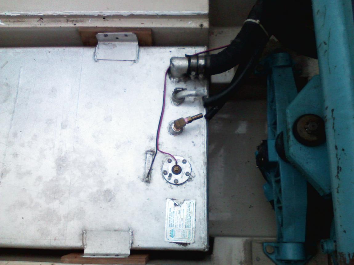

And the second picture is of the tank fittings. I was going to inspect the anti siphon valve, but I don't see it on this tank. I blew out the contents of the vent hose with compressed air. the fitting on the tank where the vent hose goes was quite dirty and corroded but couldn't tell if it was blocked. Some water and gas came out when I blew the air through it, but not very much.
I believe on top of replacing the gas that I should still do a fuel pump pressure test and the external tank test because of the information I could gather.
