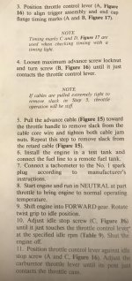

Maybe what I’m trying to do is align these marks for the throttle timing? Either way, I’m not understanding how these marks are supposed to line up. There is one solid line on the actual flywheel and also one dashed line on it and there’s one on the cowling frame to match them too but I’m looking at something else. Here’s what the manual says so maybe you guys will understand what I’m looking at better....

I have a timing light and build motorcycles so I understand how to set advance, retard, TDC....etc. I’m just trying to understand where and when all of these timing marks on the trigger and end plate and then the ones on the flywheel and cowling frame are supposed to line up. Basically I have a lot of timing marks and nothing to reference to where the marks are supposed to line up. That’s the only thing I really need to know and then I can figure out the rest on my own. This is the first outboard I’ve ever worked on so I’m trying to understand the timing marks on this particular outboard.
There's a degree scale on one side (frame?) and a TDC mark on the flywheel. Fire it up and line 'em up! Just like bikes and cars.
Jeff

Theres no degree scale on this motor. There’s only the two marks on the flywheel and then one mark to line up with on the frame that goes over the flywheel.
