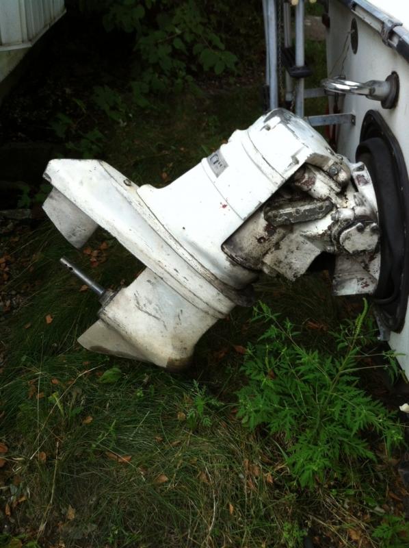

Depends on the drive, you have the electric shift or hydro-mechanical drive ? A seloc #3400 in the right hand corner will have all the info u need but for now put up a pic of the drive. We can then tell you more.

I am uploading pics as you can see I took off the propeller to make sure it was ok (seems good)

(I have a large garbage can I could fill with water) boatfoot2.jpgboatengine.jpgboatfoot1.jpg
you can just check the ball gears visually- if you ran at that angle and they are more than 50% worn, they may have failed
althought the boat may be a 1978 model, that engine/drive is not a 1978, as it is an electric shift drive pictured (1964-1977 vintage)
being an electric shift drive, you may simply have a wiring or ground problem causing the drive to disengage (it takes electric current to engage F or R on your drive)

Yes you have a electric shift that is why i asked for the pic see i knew they sometimes put a year older drive and engine setup on boats back then, sometimes 2 years older the parts were new but was in stock at the time they were building the boat.
