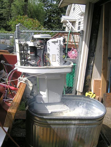

I'd have to check the manual (Seloc) but I believe it's 4500 at WOT. I'm just dialing in my 70 hp now. I had two motors, 70 and 75, both with issues and built one good one. I took the block from the 75, had it bored 0.020 over and put in new pistons, then used the carbs, and ignition from the 70.
